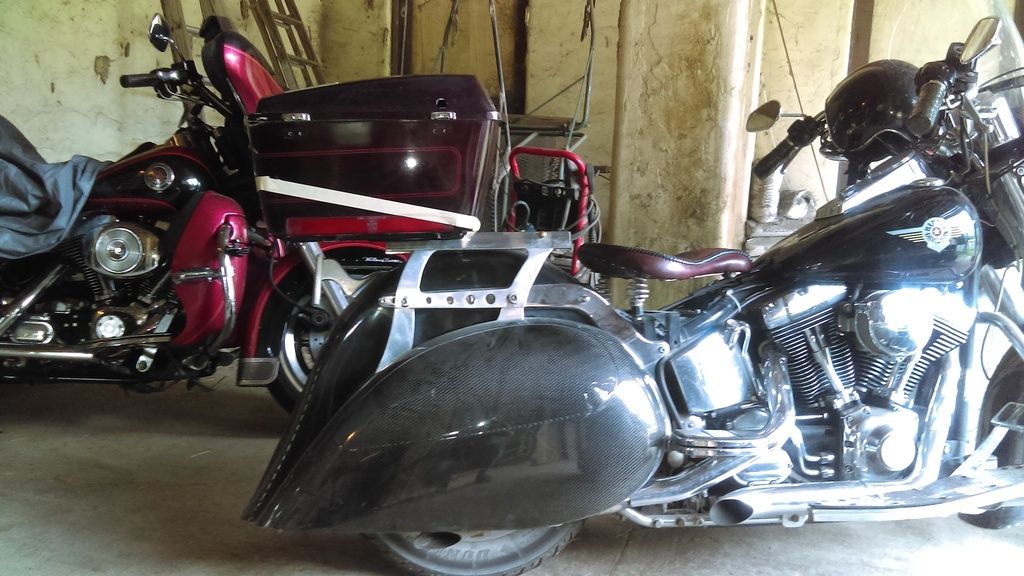

    Iím new here but know a lot of you guys from other forums so wanted to show what I have been doing for the last couple of months.
    I want a custom tour pack for my Softail, I want the basic shape of a HD pack, but want to chop it, hide the hinges, hide the latch, loose the flange, and the gasket.
    I also want to reinforce it with carbon fiber, and be able to use the HD touring back rest, but most important I want it to look like the styling on my Softail Bagger.

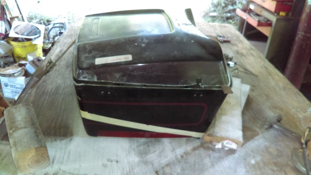

    So I picked this up on E-bay, it looks like it did a little slide down the road.
    Iím just mocking it up here on the solo rack that was a project here a couple of years ago.
    The tape shows where I want to chop it.
    I want it big enough to fit a couple of half helmets and maybe a jacket or two but donít need it huge.

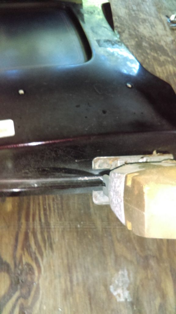

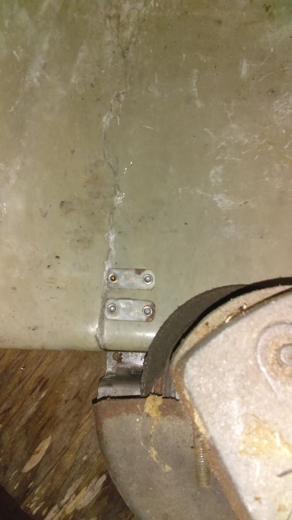

    First thing to do is grind off the rivets to take off the hinges.

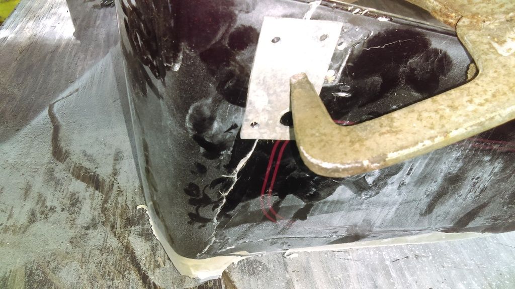

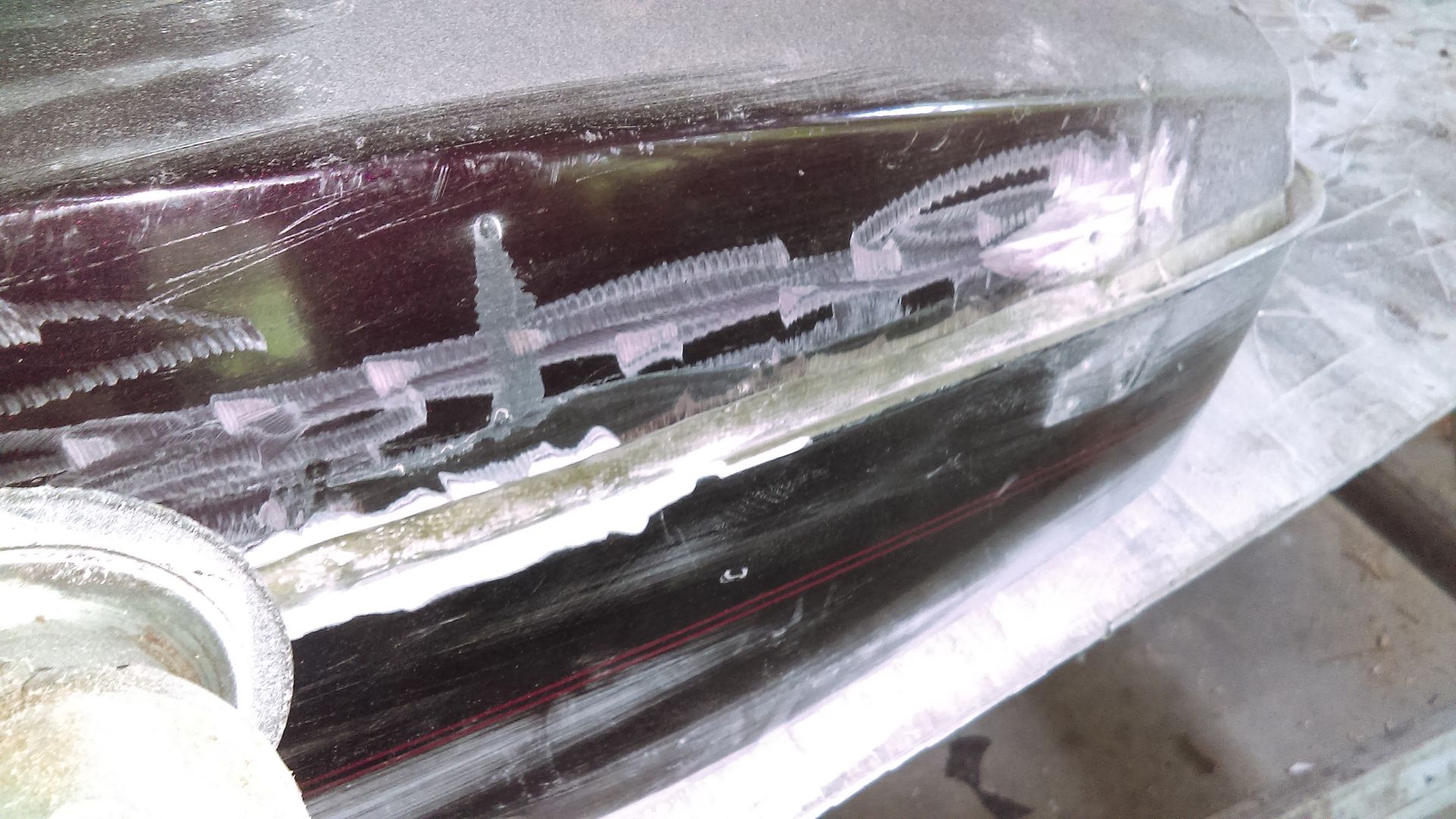

    You can see there is a nasty crack from someone opening the lid with a heavy weight on it. The fiberglass is very thin and in all honesty pretty flimsy, guess they want to keep the weight down.

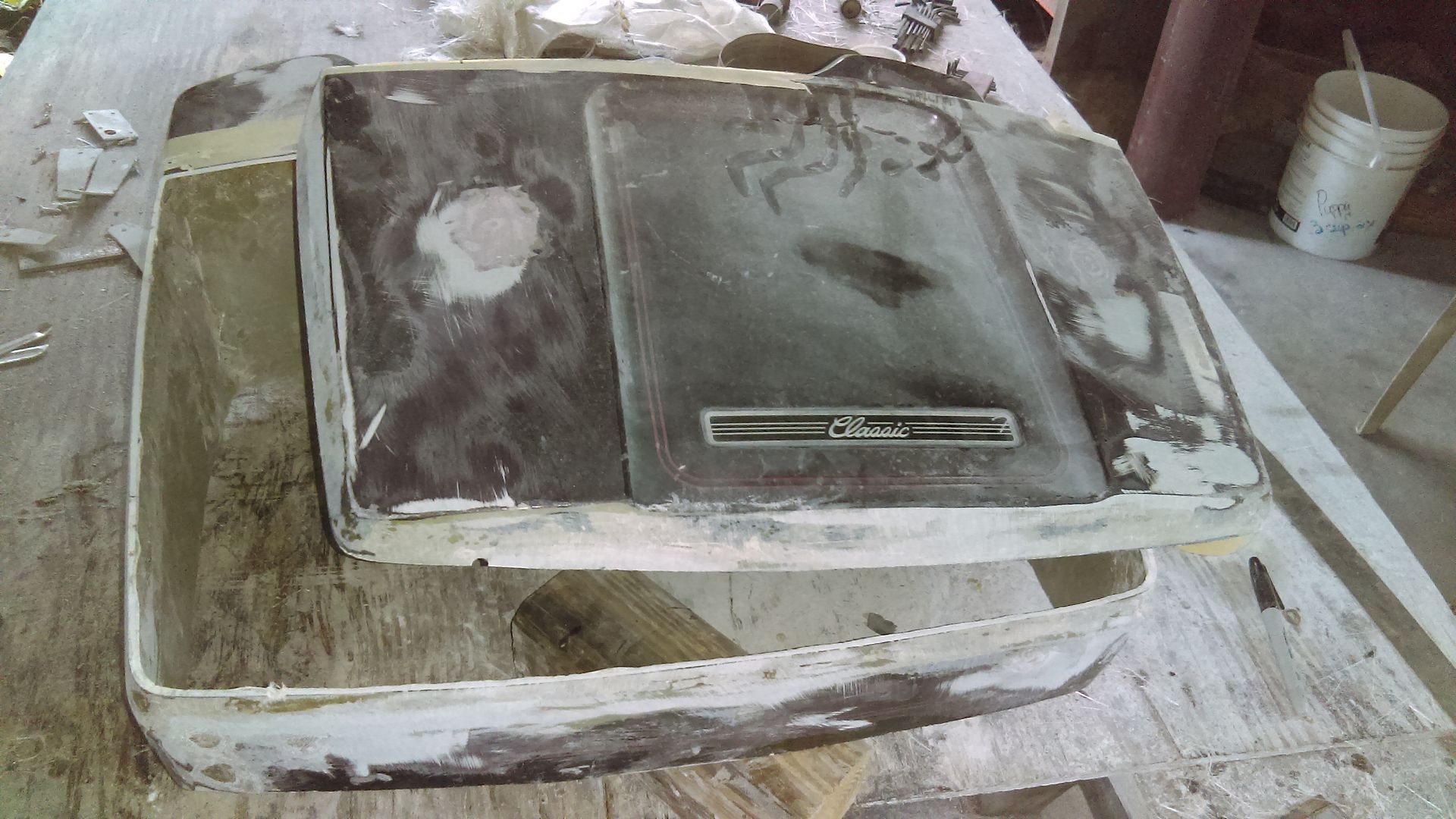

    Then start cutting off the flanges.
    Here is what it looks like without the flanges.

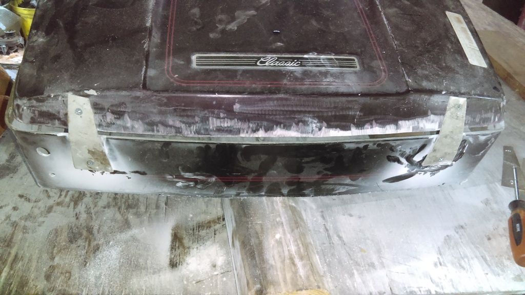

    Cut off the bottom, in order to mold the top to the bottom you need access from the bottom.
    Where the crack is I am putting this temporary brace to hold it together.
    All the edges have been sanded with a grinder so that the new resin will bond.

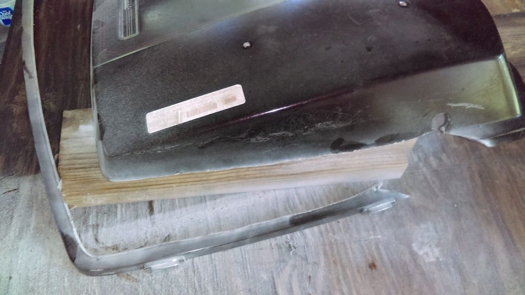

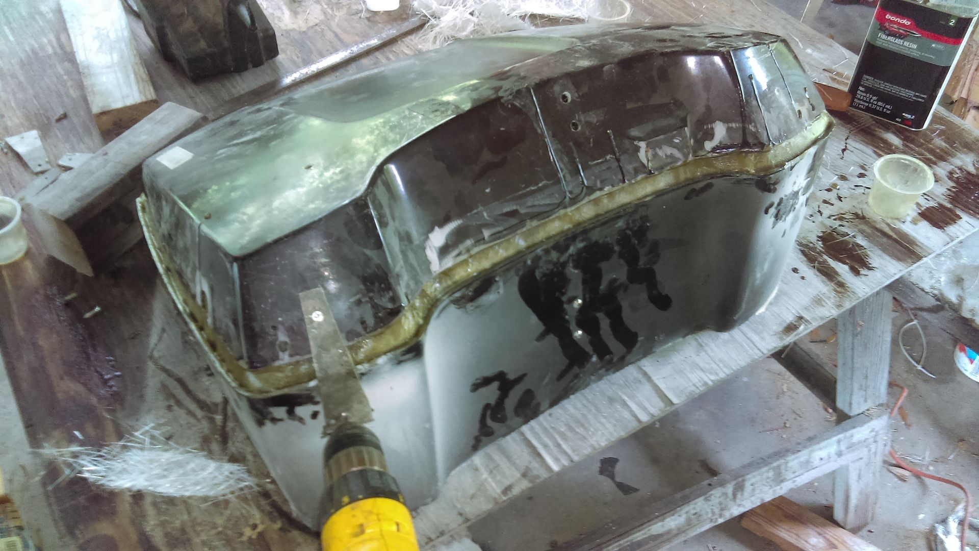

    The top is smaller than the bottom so it needs a space so that when you start filling the gap it will match up. The braces are to keep the top in place, they are temporary there are also two in the front.

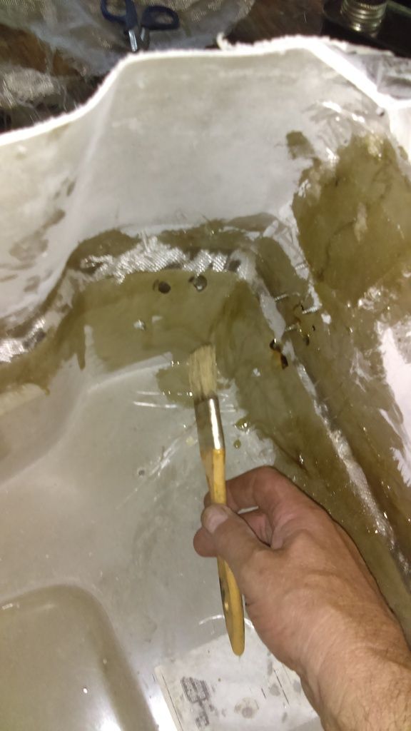

    Turn it upside down. Next comes the glass and resin.
    Iím just putting 1-2 layers to get it started. A side note, there are two types of polyester resin used mostly with fiberglass, waxed and un-waxed, the un-waxed is used mostly for layup in big molds where there are multiply layers. It is cheaper and sold in large containers, the waxed version is considered a premium resin and is used mostly for repairs, it has a wax that seals the resin as it dries and keep the resin from being sticky when dry. This is what I like to use for small jobs like this.

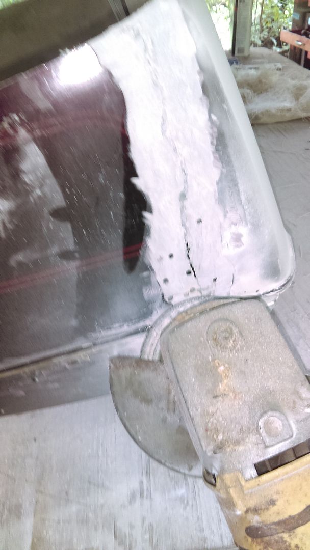

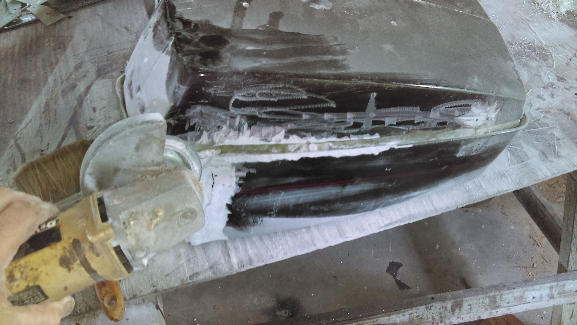

    Now to start on the outside, first grind down where it was cracked to the inside where you just put the inside layer.
    You want to eliminate as much damage as possible.
    Then I need to get rid if the rest of the lower flange on the bottom of the pack.
    I’m also beveling the bottom edge so my new glass will be smooth, and adhere.

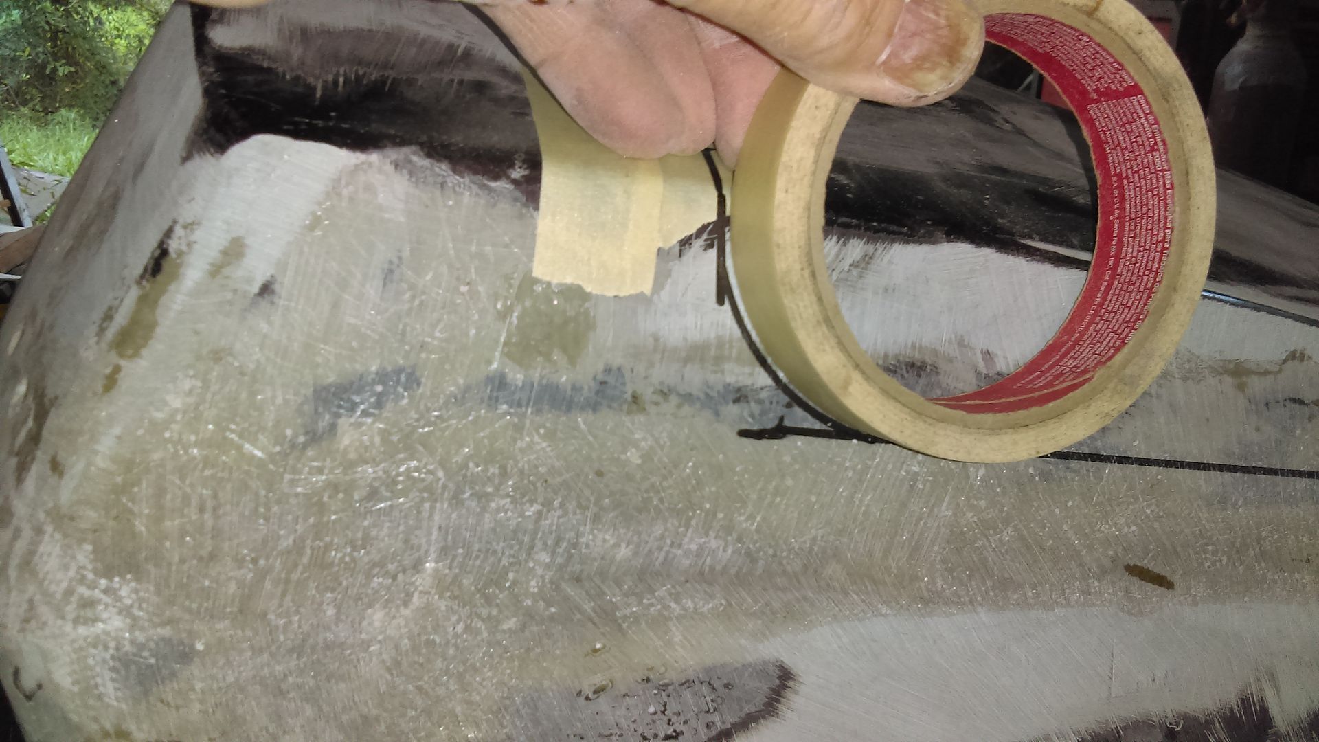

    Then need to roughen up the gel coat so the new resin will adhere.
    And yes that is pretty aggressive paper, think 50.

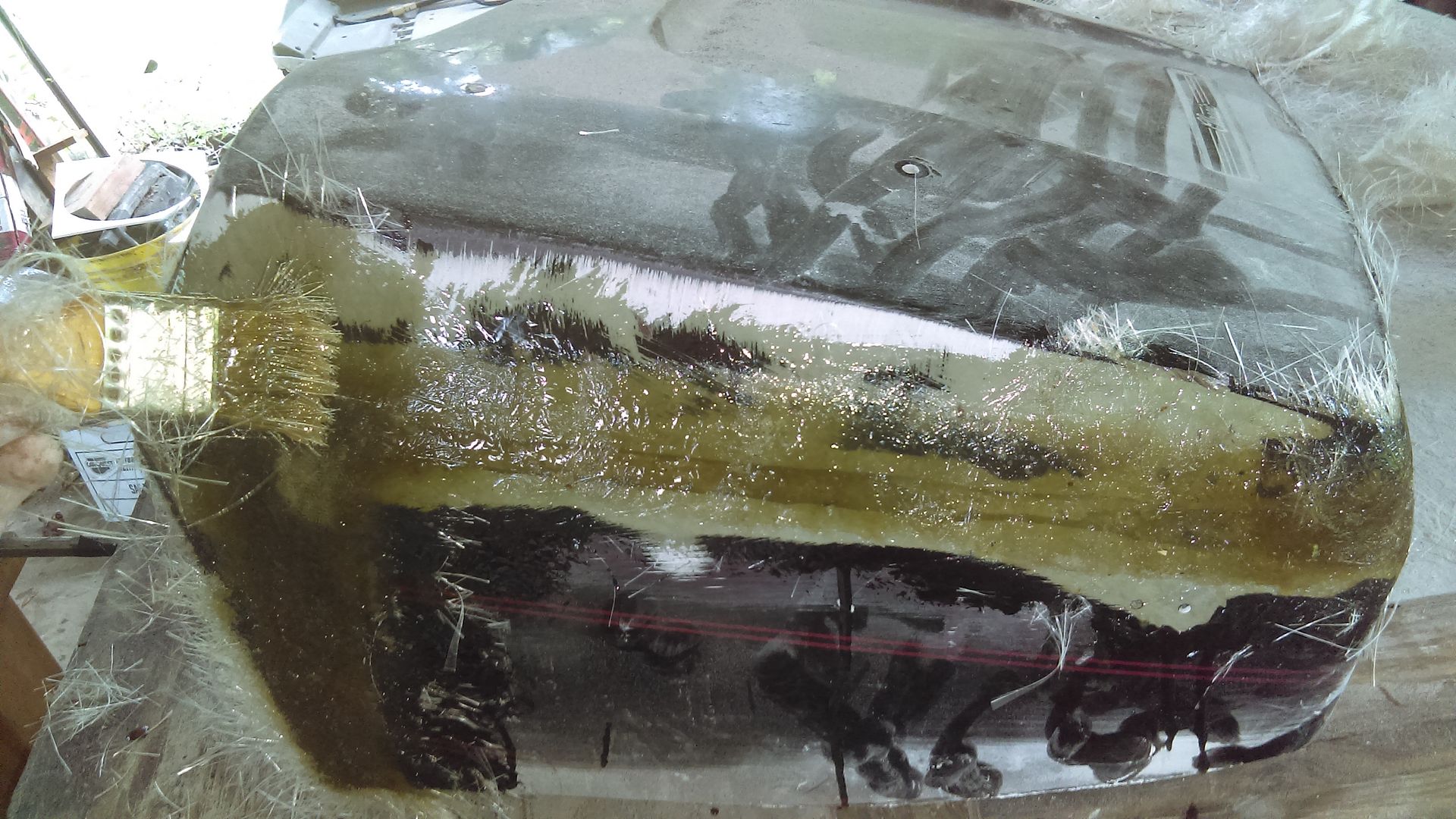

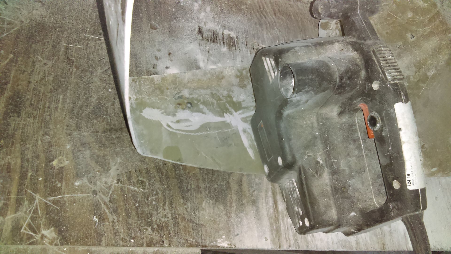

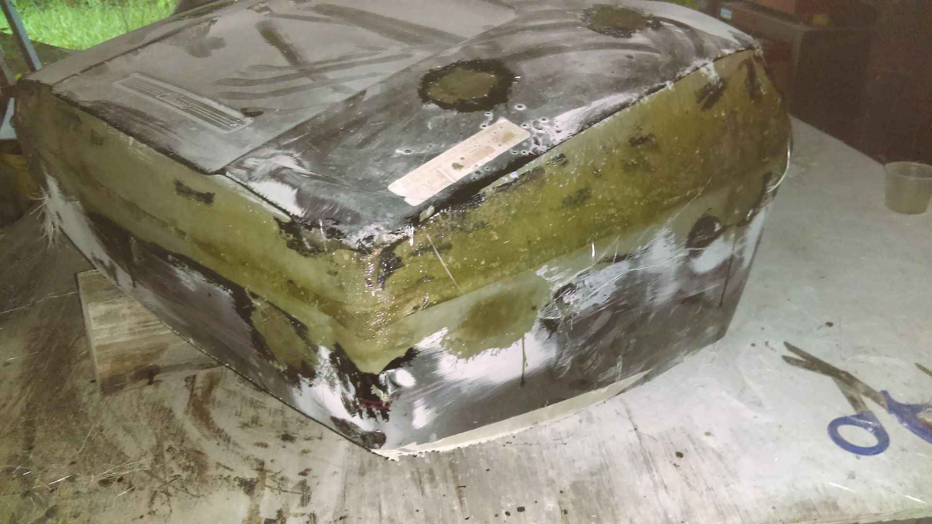

    Then ready to start building up on the outside with glass.
    That is probably four to six coats of glass, I use a combination of mat and woven depending on what I am doing, before I used the woven because I was stretching between the two parts, today I am using the mat because it builds quicker and is cheaper.

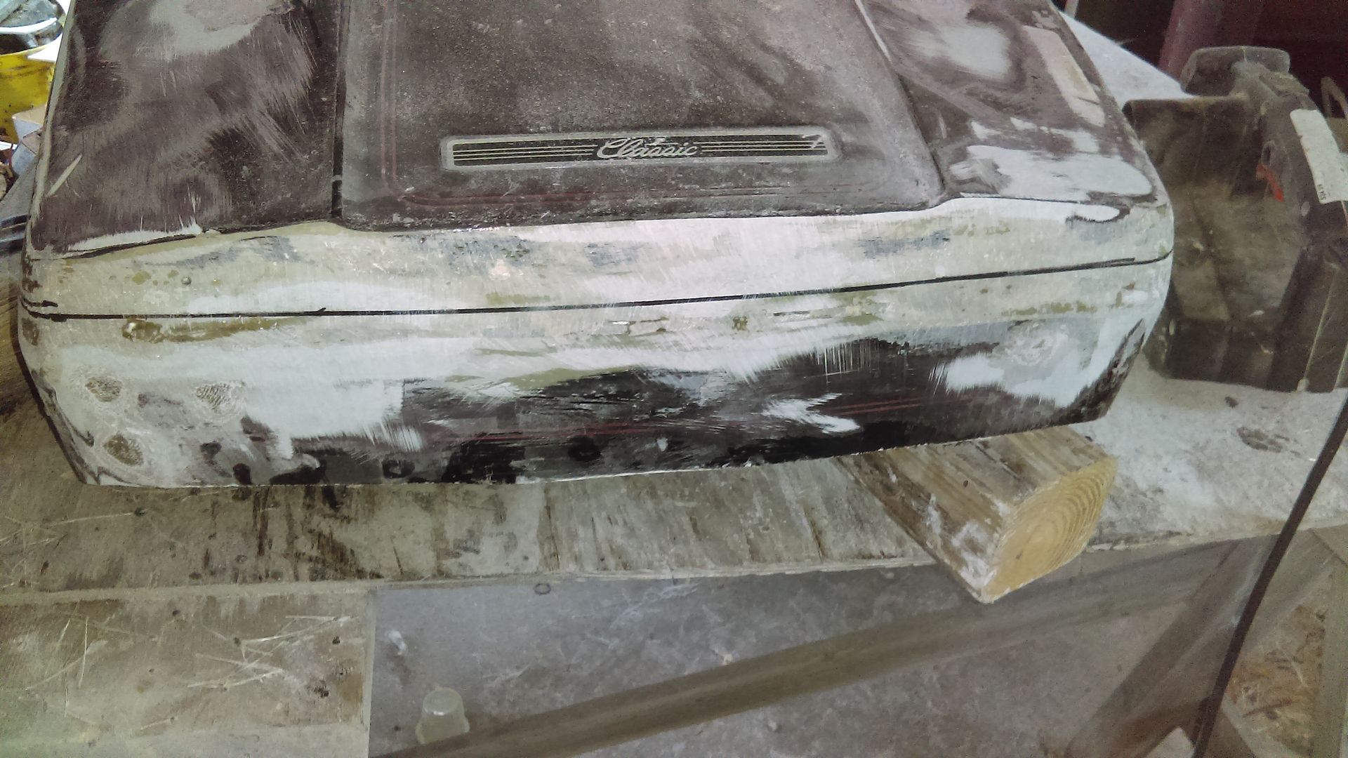

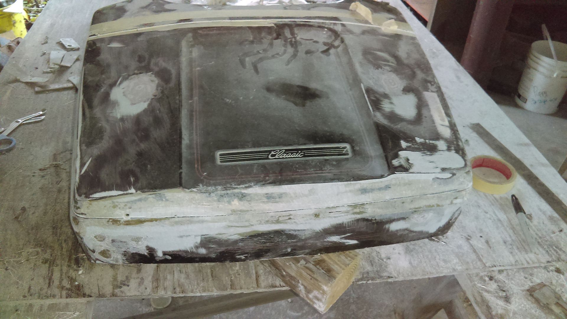

    You give it a good sanding, it is very straight and symmetrical, It had a few low spots, so those got filled in, and a final layer of woven mat. At this point you don’t need to worry about making it perfect, you just want to make it as symmetrical as possible, that is hard to correct later.
    I’m not sure what I want to do where the logo goes, I don’t know if I want to fill it in or make a custom name tag for it.
    It needs another sanding then it will be ready to cut the lid open, and start making the new hidden lip to keep water out.

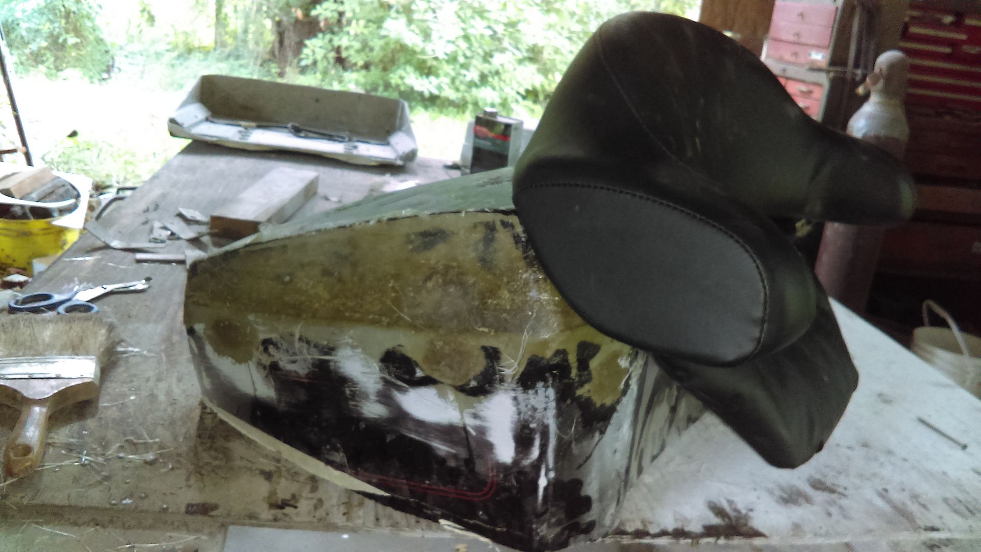

    I picked up this back rest on Ebay, it is the main reason for the tour pack, yes Mrs Cruiser’s comfort, you know happy wife happy life. It will also help hide the big wide seat that looks so out of place on my bike when she rides along. Ten fifteen years ago, I made up a set for her out of an old FLH seat. In all honesty it looks hideous on my bike, but it is so comfortable for her that she won’t ride on anything else. I bought her a Corbin, she hates it. I am trying to buy a Sundowner but I know she won’t like it either.
    In all honesty I can’t figure out how we feel the driver deserves a seat sixteen inches wide but the passenger only deserves a seat ten inches or even twelve.
    So that is the main reason for the tour pack to help hide the big seat.
    This back rest needs some work, it is broken on one side where it bolts on, so will need to pull off the cover and fix that, it also needs to be altered some to clear where the lid is going to open, will talk about that later.

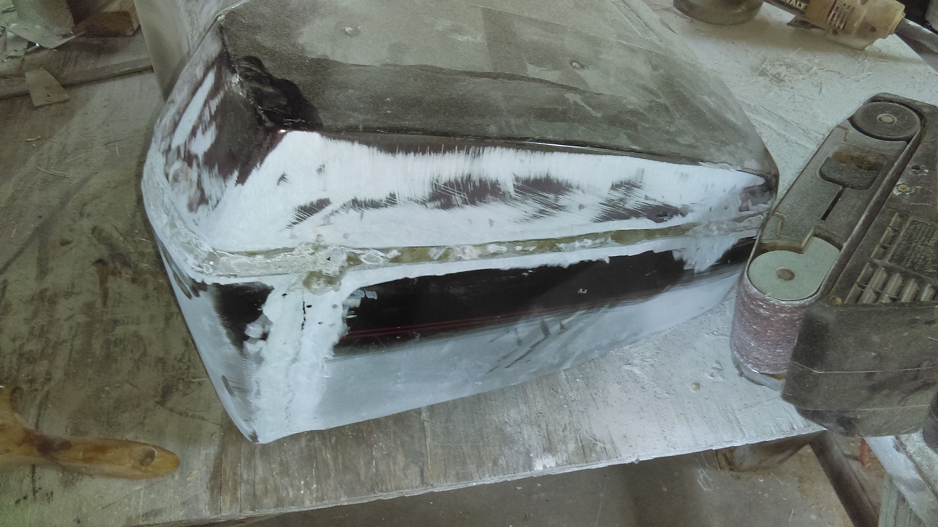

    I was able to get the rough glass sanded down it is very smooth, it still needs some work but at this time it is fine. There is no need to get it perfect because fiberglass has a built in stress that when it is cut it will warp. Kind of like wood when it is cut from a log, it bends with the grain. So we want to do all the cutting before we finish the final body work. There is also going to be a lot of work on the seams of the lid, so lets leave the finish work for last.

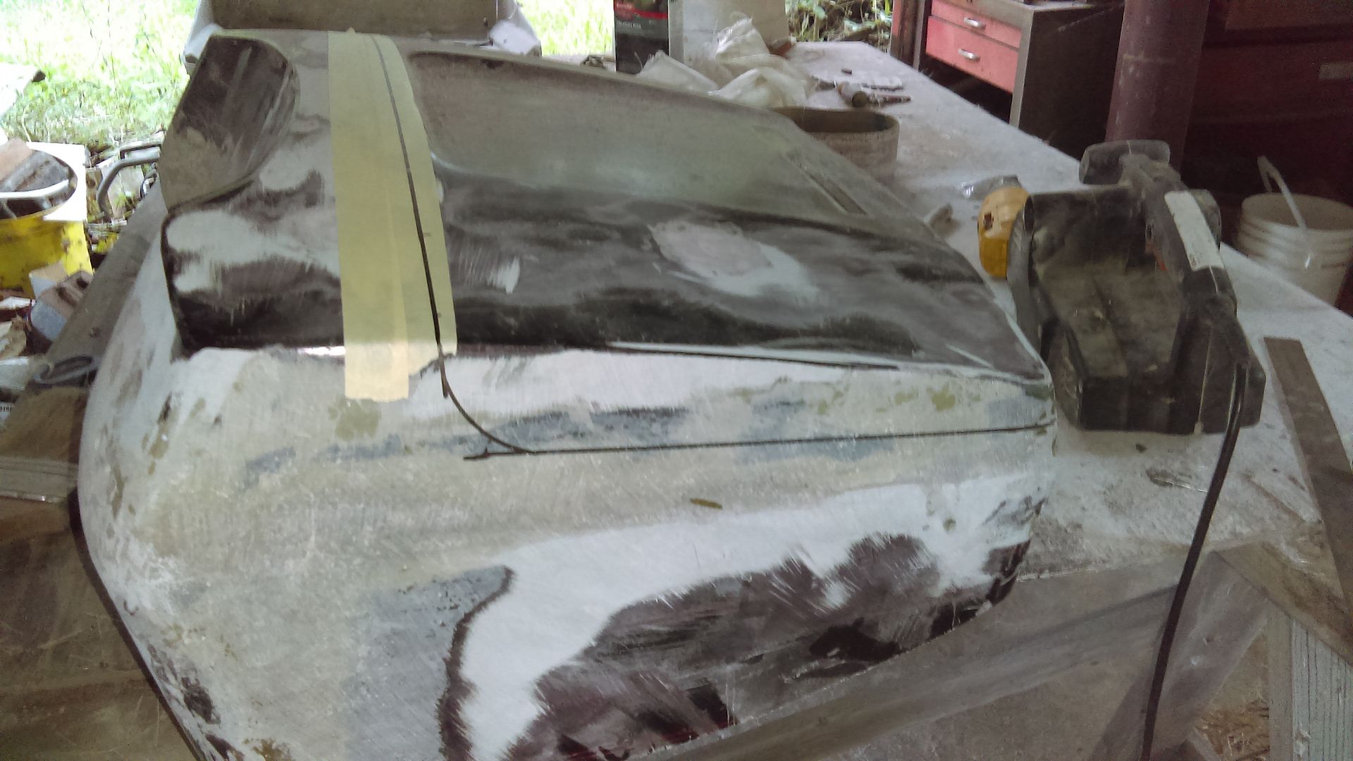

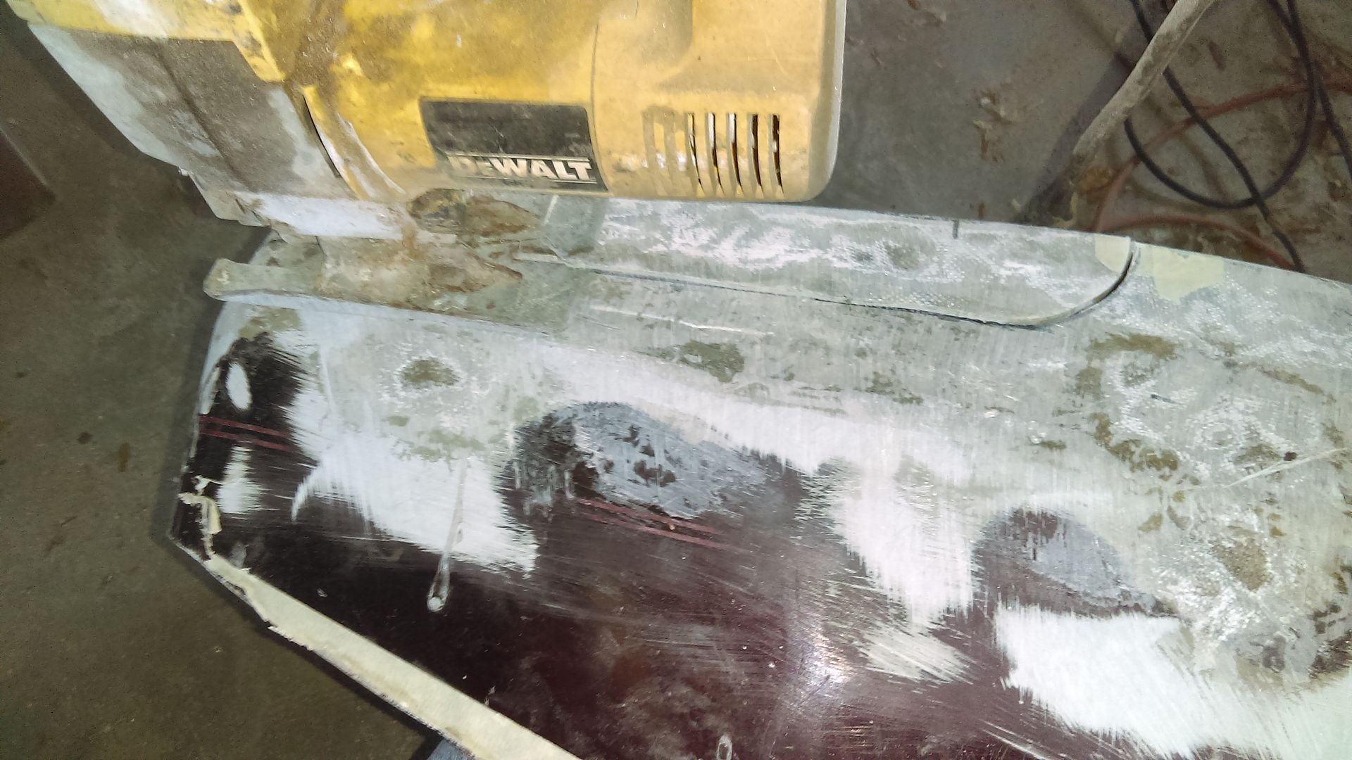

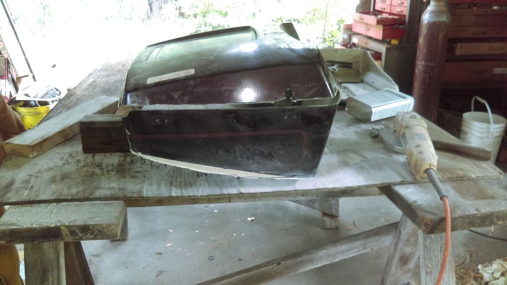

    Moving on, here is where the lid is going to be cut out.
    Fiber glass does not like square corners, just like aluminum and steel it causes stress points so use anything handy for the radius.
    You need to drill a small hole to get your blade in so did that in the back, if will be fixed when the final body work. (you can see that in a couple of photos down.) Then you just start cutting, fiberglass is horrible on saw blades so start with a new blade so that you are not fighting it. When you fight it you start pushing too hard and that is when you get crooked. Decide which side of the line you are going to cut and stay on that side.
    I want the lid to be hinged from the back, I don’t want the back rest to be fastened to the lid, I want it to be fastened to the base. I want the lid to be flat where it closes so I cut it a half inch from the recessed part even though the back rest covers this slightly. You can see that in the above photo. I will have to modify the back rest so that it does not come that far back on the tour pack.

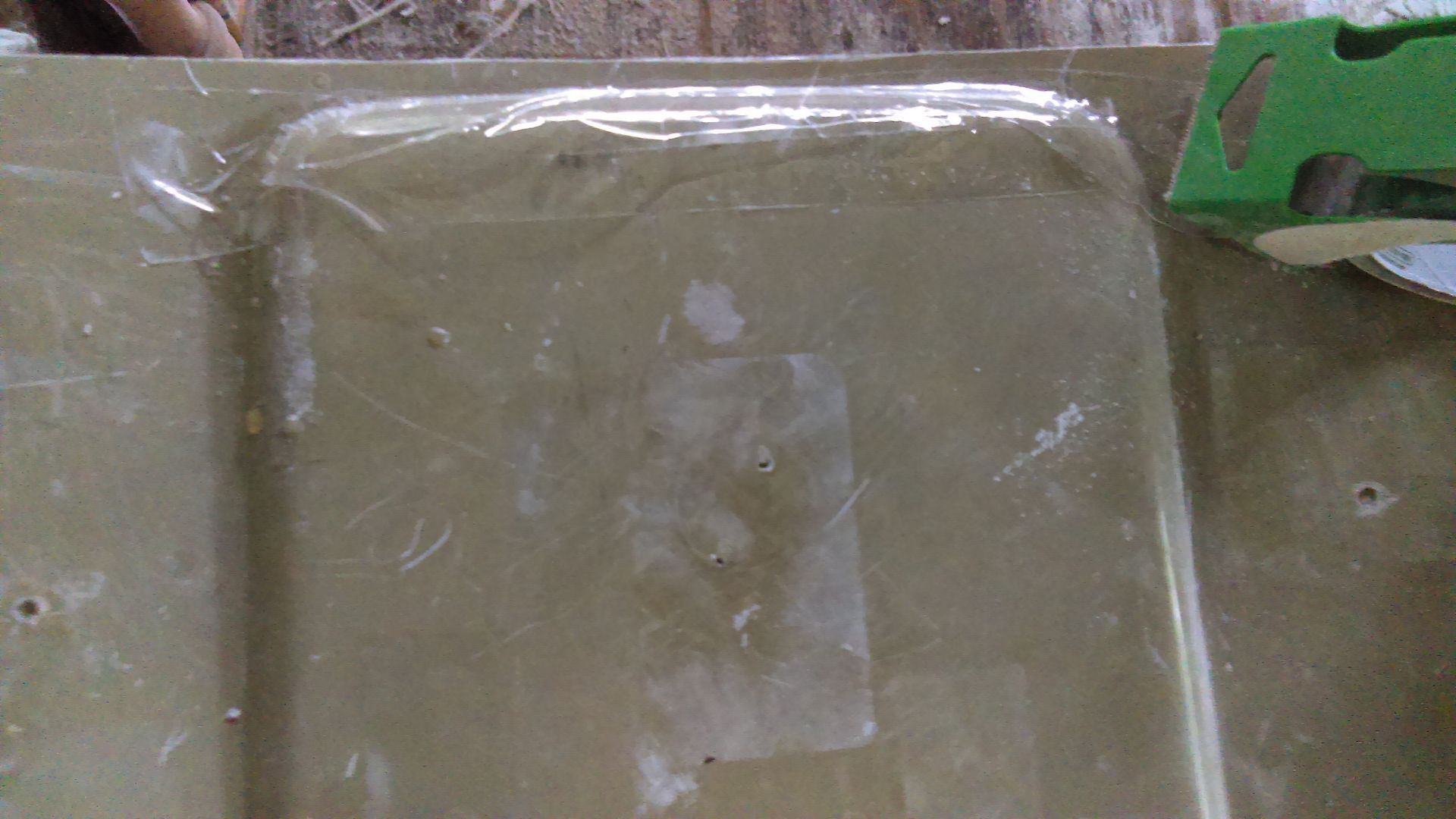

    The inside needs to be cleaned up rough up so the resin adheres
    Then the top needs to be taped off so the resin does not stick, I’m using clear shipping tape..
    Then glass in where the new lip goes.
