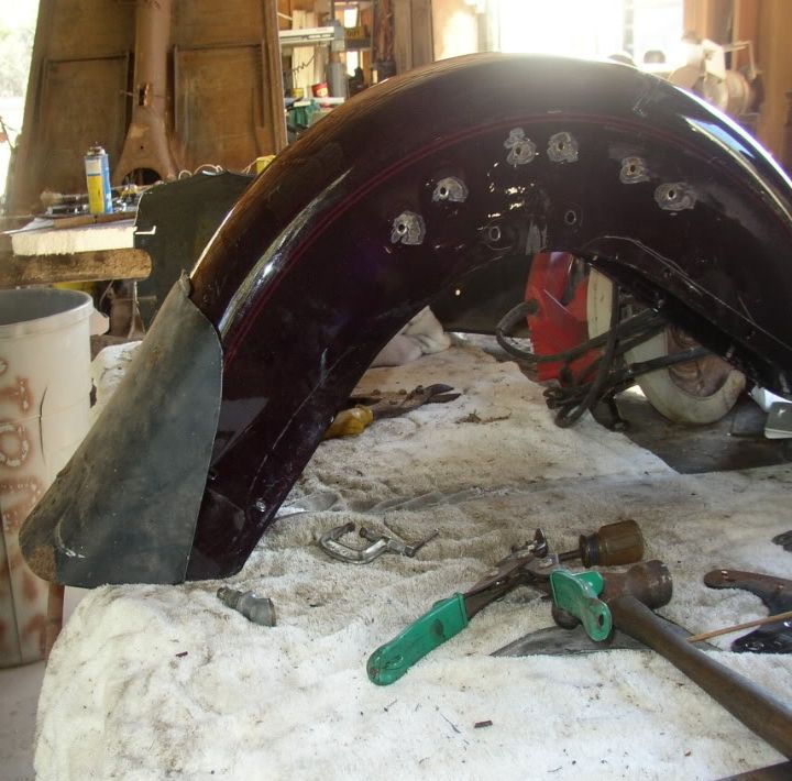

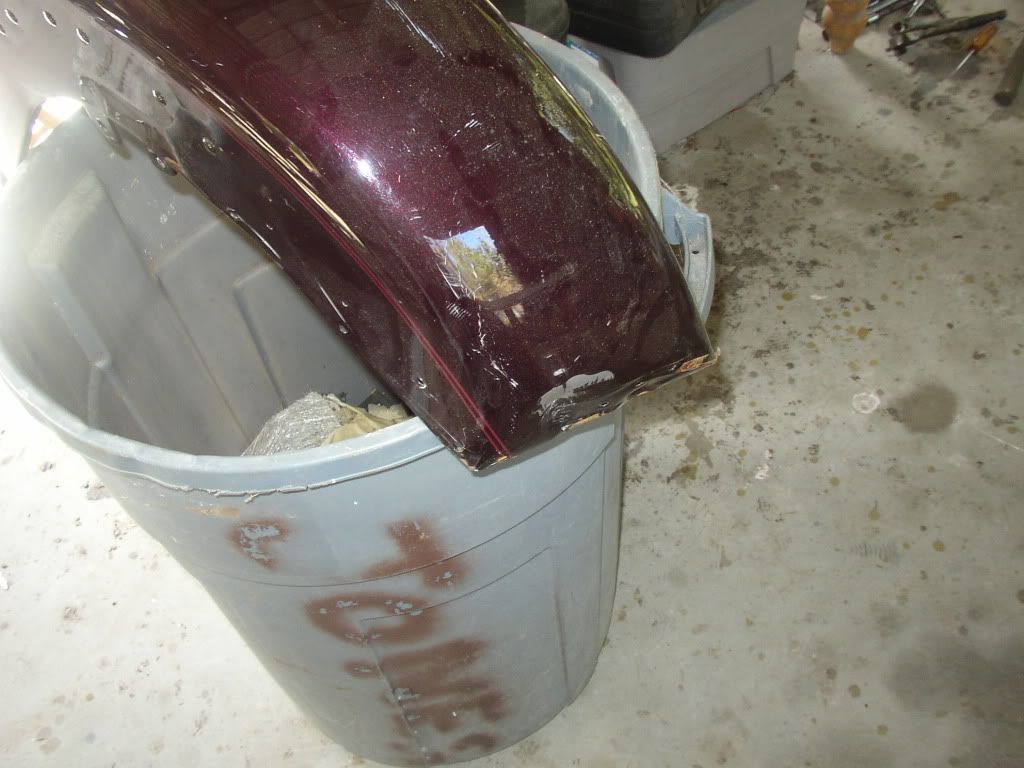

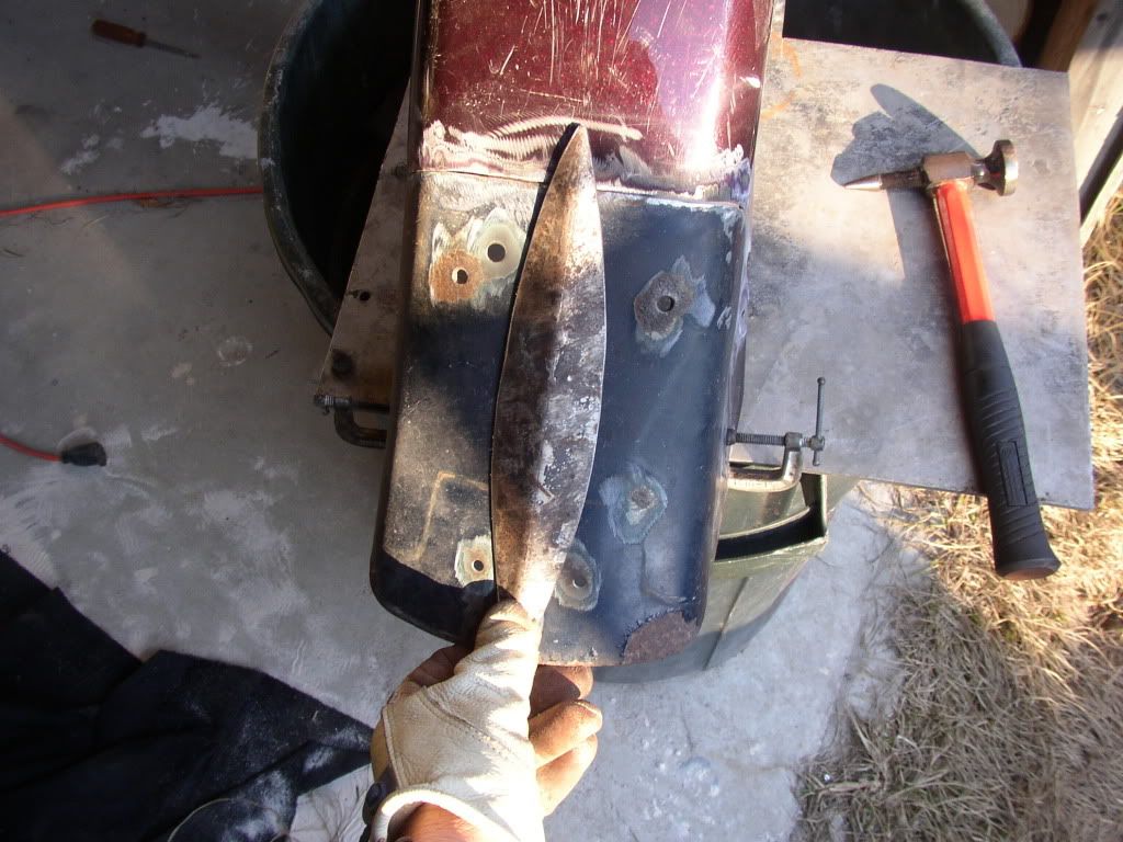

    This fender was a project, been maybe six seven years ago, here is how it started out, an eBay banged up special.
    I straightened up the front and added the tail from a rear fender.
    Then added a ridge up the back to match the rear fender.

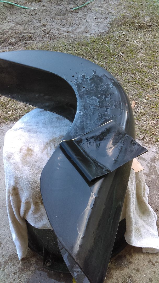

    I ran it for several years and I banged it up pretty bad when I hit a deer a couple of years ago and started to repainted it, as you can see the paint is not perfect, then bumped my gate before the paint was done about a year ago and have been ignoring it. So now is the time to redo it.

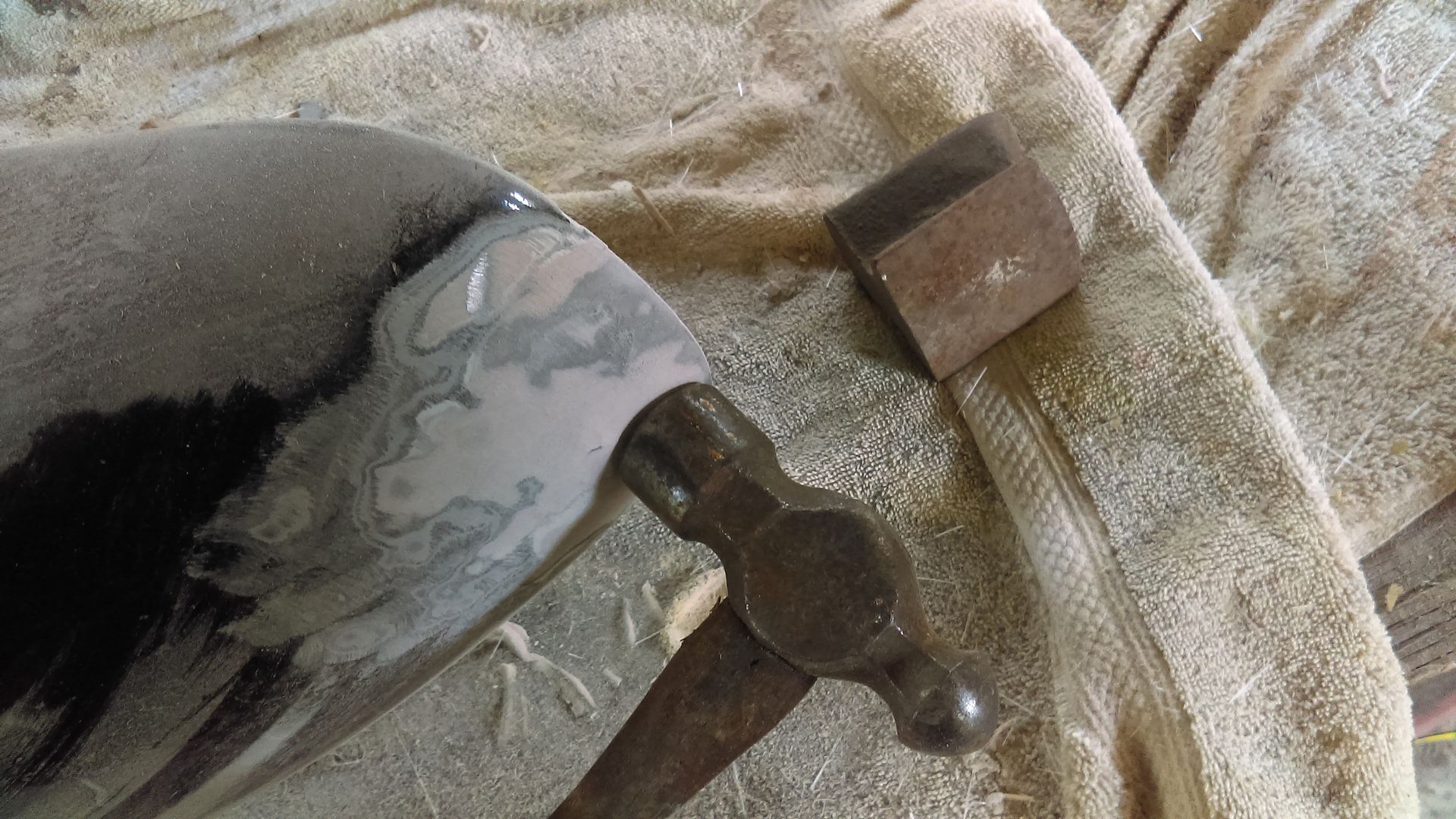

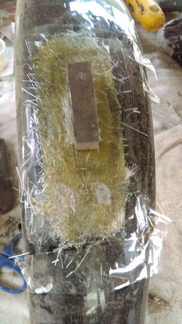

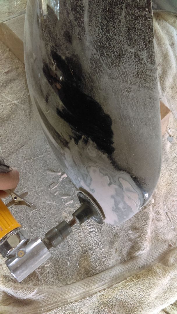

    Grind off the cracked paint and filler.
    Hammer and dolly to get it straight, it had spread some so you just pull it in by laying it flat and pushing down on it.
    I need another sanding block.

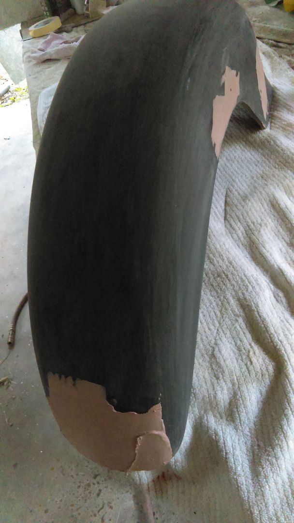

    New body filler on all the damaged areas.

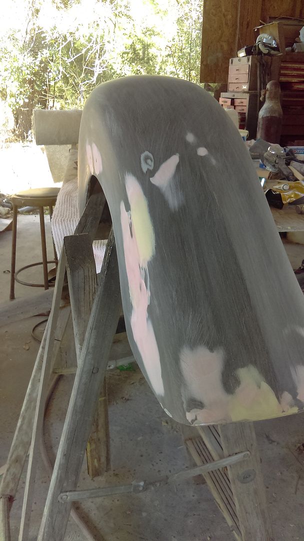

    Then sand it smooth.
  4. #84
    Too many photos :-)
    Prime it with the high build primer.
    And then you start your final wet sanding, here with 320 wet. There are a few real small spots that need the finish filler another sanding and spot shot with primer in my air brush, then ready for paint.
