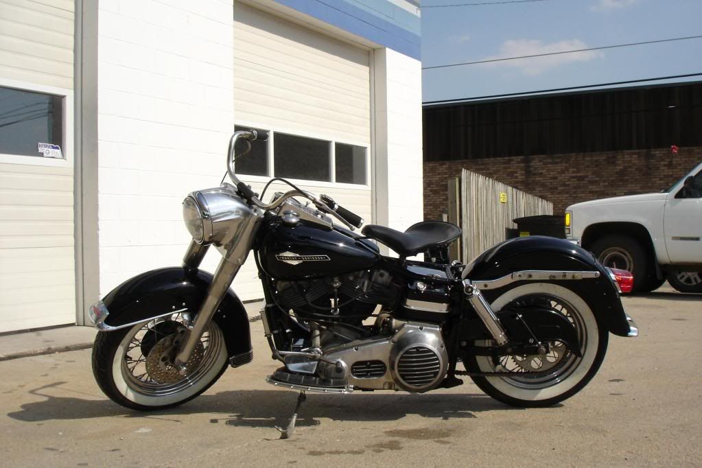

    after about a week, this is where the bike was at. It stay at this point for about a year before I decided to paint it.

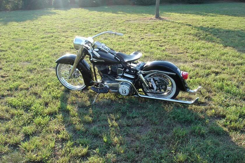

    few changes over that time included, 16 apes, 67 rear swing arm and drum brake. PM front brake. Added driving lights back on. Jockey shift.

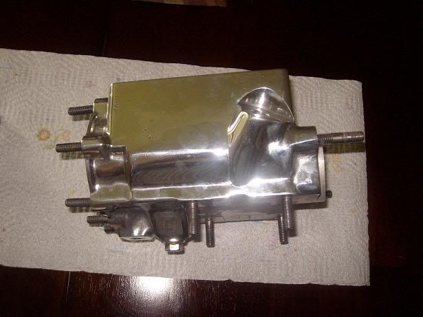

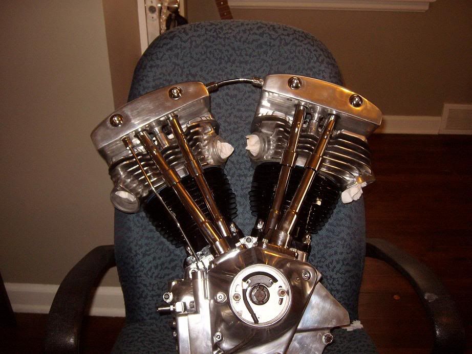

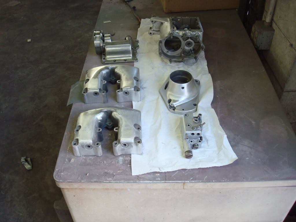

    The motor and trans were taken in for a complete rebuild. The cases and heads were sent off for a complete polishing job. The trans and other tid bits I did myself.
    Starting of polishing...

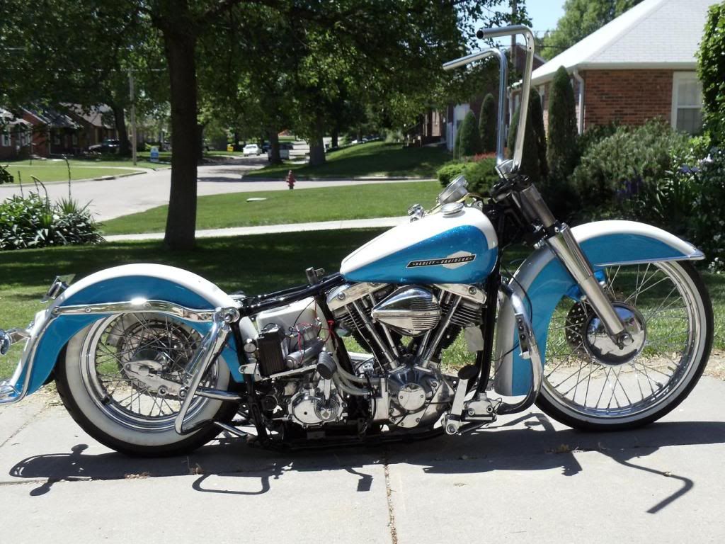

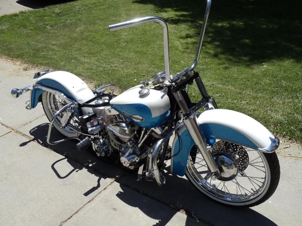

    Originally I had painted the bike a heavy blue metal flake and pearl white 2 tone. At this point I was running a 21/16 wheel combo, eventually changing to a 21/18 and then to 23/18. In changing to the 23 front wheel that also changed the front fender, to which i did my best to try matching the blue and white, but after 2 failed attempts, I changed the color. While I changed the color, the rear fender was turned back 4 inches, changed the tail light, did some hammer and dolly work to finish the body lines on it as well. More on all that as the thread continues.
    So after about a year of work, it was at this point...

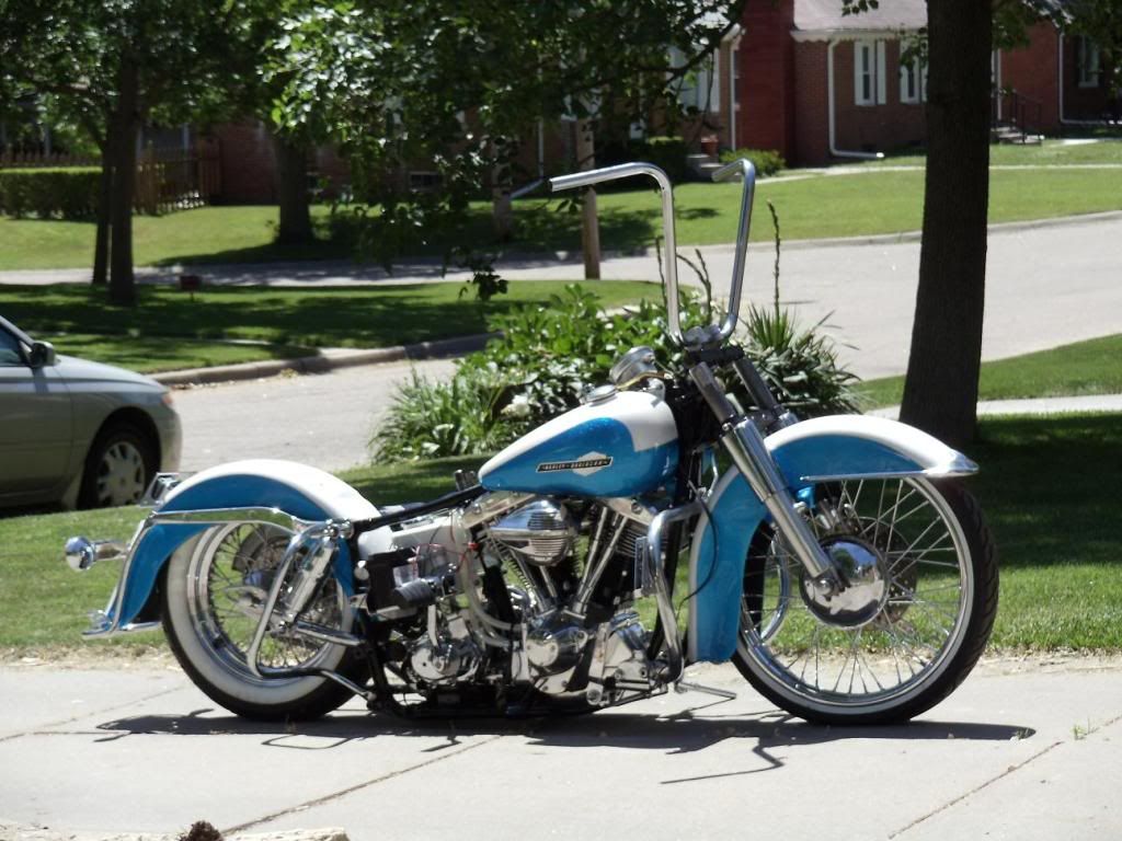

    I switched the front tubes and sliders to a later style from a 88 road king. I wanted a better looking rotor, hated the PM caliper mount for the 75 front forks (looks clunky and just cheap) I wanted a direct bolt on caliper. This also made it easier to use the pistons from marc and install lowering dampers .
    The front fender idea came from torch industries, they had built a bike called pan dejo. Loved the front fender/23 wheel combo and had to have it. I ordered up a springer fender and got busy cutting and making it fit...
    rear fender was a factory hinged fender, rolled back 4 inches, hinged area welded together and tail light raised back to the original spot. The rear fender body lines were also finished to match the front fender body lines.
