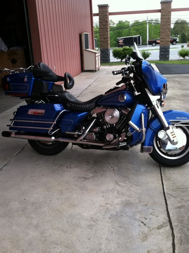

    Iím not gonna put much back story here as this is all about the build and getting to what Iíve been after for a few years. Iíve been buying, fixing, modifying, and flipping bikes for the past couple years to raise funds for my Harley and this project. Here is what I started with:
    1997 Ultra Classic with 50K, top end just rebuilt by Harley, picked it up from my local HD dealer for a steal.
